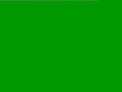

Hi all,
I want to get stream from two of my cameras in single MIPI CSI. Currently I have the setup below:
I did find some useful information on the below forum post:
bring up dual Camera under single mipi csi
however, those modifications didn't work for me, but it was a good head start.
I change the device tree like below:

and here is the changes I made on the `imx8-mipi-csi2-sam.c` and `imx8-media-dev.c`.

with the above changes I manage to get this log from the dmesg:
[   13.882103] mxc-mipi-csi2 58227000.csi: lanes: 2, name: mxc-mipi-csi2.0
[   13.910417] mxc-mipi-csi2 58247000.csi: lanes: 2, name: mxc-mipi-csi2.1
[   13.925936] mxc-isi 58110000.isi: mxc_isi.1 registered successfully
[   13.933616] mxc-isi 58150000.isi: mxc_isi.5 registered successfully
[   13.945677] mx8-img-md: Registered mxc_isi.1.capture as /dev/video2
[   13.952694] mx8-img-md: Registered mxc_isi.5.capture as /dev/video3
[   13.959160] mx8-img-md: port full name is camera
[   13.963813] mx8-img-md: port full name is port@0
[   13.968440] mx8-img-md: port name is port
[   13.972455] mx8-img-md: ep full name is endpoint and ep name is endpoint
[   13.979270] mx8-img-md: port full name is port@1
[   13.983896] mx8-img-md: port name is port

Hello @Bio_TICFSL,
I check out the latest BSP, if I understood it correctly, the approach is basically didn't changed.
I can get some output from video3 and video4, which is both connected to csi2.0.
[   14.313983] mx8-img-md: num_sensors is (4)
[   14.318097] mx8-img-md: sensor is (as0149 2-005f), sd (69904512)
[   14.324920] mx8-img-md: sensor->id is (0)
[   14.328947] mx8-img-md: mipi_vc is (1)
[   14.332708] mx8-img-md: j is (0)
[   14.335973] mx8-img-md: created link [as0149 2-005f] => [mxc-mipi-csi2.0]
[   14.343561] mx8-img-md: sensor is (as0149 2-005e), sd (70127744)
[   14.350392] mx8-img-md: sensor->id is (1)
[   14.354419] mx8-img-md: mipi_vc is (1)
[   14.358179] mx8-img-md: j is (0)
[   14.361413] mx8-img-md: created link [as0149 2-005e] => [mxc-mipi-csi2.0]
[   14.369019] mx8-img-md: sensor is ((efault)), sd (0)
[   14.374009] mx8-img-md: sensor is ((efault)), sd (0)

but the output is green, and at the top of the screen there are statics. Like below:
How can I possibly solve this ? Also from media-ctl -p -d 1:
