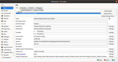

We are using the SDK built by the command "bitbake -c populate_sdk imx-image-full", and try to configure the kit on Qt creator.
But There is an error when we try to build a CMake project ( only has a windows, created by Qt creator named “untitled”), see the message as follow:
[cmake] Running /home/vmware/Qt/Tools/CMake/bin/cmake -S /home/vmware/untitled1 -B /home/vmware/untitled1/build/IMX8_Qt_6_7_0_cross_compiler-Debug in /home/vmware/untitled1/build/IMX8_Qt_6_7_0_cross_compiler-Debug.
[cmake] -- The CXX compiler identification is GNU 13.2.0
[cmake] -- Detecting CXX compiler ABI info
[cmake] -- Detecting CXX compiler ABI info - failed
[cmake] -- Check for working CXX compiler: /opt/fsl-imx-xwayland/6.6-scarthgap/sysroots/x86_64-pokysdk-linux/usr/bin/aarch64-poky-linux/aarch64-poky-linux-gcc
[cmake] -- Check for working CXX compiler: /opt/fsl-imx-xwayland/6.6-scarthgap/sysroots/x86_64-pokysdk-linux/usr/bin/aarch64-poky-linux/aarch64-poky-linux-gcc - broken

[cmake] /opt/fsl-imx-xwayland/6.6-scarthgap/sysroots/x86_64-pokysdk-linux/usr/libexec/aarch64-poky-linux/gcc/aarch64-poky-linux/13.2.0/ld: cannot find Scrt1.o: No such file or directory
[cmake] /opt/fsl-imx-xwayland/6.6-scarthgap/sysroots/x86_64-pokysdk-linux/usr/libexec/aarch64-poky-linux/gcc/aarch64-poky-linux/13.2.0/ld: cannot find crti.o: No such file or directory
[cmake] /opt/fsl-imx-xwayland/6.6-scarthgap/sysroots/x86_64-pokysdk-linux/usr/libexec/aarch64-poky-linux/gcc/aarch64-poky-linux/13.2.0/ld: cannot find crtbeginS.o: No such file or directory
[cmake] /opt/fsl-imx-xwayland/6.6-scarthgap/sysroots/x86_64-pokysdk-linux/usr/libexec/aarch64-poky-linux/gcc/aarch64-poky-linux/13.2.0/ld: cannot find -lgcc: No such file or directory
[cmake] /opt/fsl-imx-xwayland/6.6-scarthgap/sysroots/x86_64-pokysdk-linux/usr/libexec/aarch64-poky-linux/gcc/aarch64-poky-linux/13.2.0/ld: cannot find -lgcc_s: No such file or directory
[cmake] /opt/fsl-imx-xwayland/6.6-scarthgap/sysroots/x86_64-pokysdk-linux/usr/libexec/aarch64-poky-linux/gcc/aarch64-poky-linux/13.2.0/ld: cannot find -lc: No such file or directory
[cmake] /opt/fsl-imx-xwayland/6.6-scarthgap/sysroots/x86_64-pokysdk-linux/usr/libexec/aarch64-poky-linux/gcc/aarch64-poky-linux/13.2.0/ld: cannot find crtendS.o: No such file or directory
[cmake] /opt/fsl-imx-xwayland/6.6-scarthgap/sysroots/x86_64-pokysdk-linux/usr/libexec/aarch64-poky-linux/gcc/aarch64-poky-linux/13.2.0/ld: cannot find crtn.o: No such file or directory
[cmake] collect2: error: ld returned 1 exit status

And here are the configurations of the kit
(g++ is the file in the same path as gcc)
How could we solve this problem. We are not sure if is correct that we comment out the code about test-compiling.

You are using other BSP that is not from NXP, so the BSP from NXP has the proper toolchain to compile and build this part, SO or its simple the toolchain or you download and try the NXP BSP.
2,613件の閲覧回数
Mingheng
Thanks for you reply @Bio_TICFSL
We are using the default configuration of it, following the user guide https://www.nxp.com.cn/docs/en/user-guide/IMX_YOCTO_PROJECT_USERS_GUIDE.pdf .
Then after this BSP building, we used `bitbake -c populate_sdk imx-image-full` to build the sdk.
Could you please provide the link about NXP BSP and SDK you said above?
