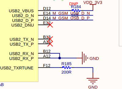

Hello, we are trying to port cellular module from quectel with USB interface,
on the /dev/ directory some devices should be created like /dev/cdc-wdmX but we don't see anything on the USB side, here are some of the logs attached:

Which version BSP are you using? How about your usb design in your board?
2,896件の閲覧回数
Wobaffet
Senior Contributor I
We re using kernel version 5.15 we are on kirkstone branch, developing with yocto.

We are using USB with minimal configuration like attached below.
2,853件の閲覧回数
Rita_Wang
For the USB2_VBUS you DNP the R184, Recommend you add it.

Yes, we've add R184. But still our module is not being recognized.
Before configuring device tree, lsusb command were outputting:
root@imx8mp-lpddr4-evk:~# lsusb
Bus 004 Device 001: ID 1d6b:0003 Linux Foundation 3.0 root hub
Bus 003 Device 001: ID 1d6b:0002 Linux Foundation 2.0 root hub
After devicetree update for USB 2: we get like I've posted earlier. I think USB is up and working but option driver is not working even though I've added vid and pid information that quectel provided.
