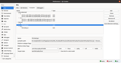

And here are the configurations of the kit
(g++ is the file in the same path as gcc)
How could we solve this problem. We are not sure if is correct that we comment out the code about test-compiling.
