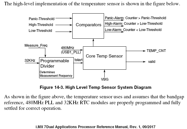

I am checking IMX7D internal temperature sensor section. (Section 14.2) in TRM version "i.MX 7Dual Applications Processor Reference Manual, Rev. 0.1, 08/2016". I found "Figure 14-3. High Level Temp Sensor System Diagram" is missing there. I downloaded the TRM from the below link.
i.MX 7Dual Arm Cortex-A7 Processor|NXP
I need to check for "High Level Temp Sensor System Diagram". Any help?

diegoadrian
The image will be added in the next RM release.
For the moment you can use this image as reference.
