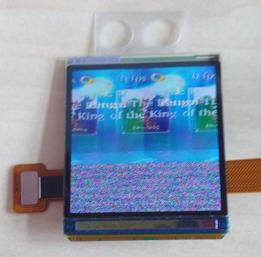

The board is a custom board based on the imx6DL processeor. The display is a 320x320 (24bit) RGB AMOLED MIPI display (X163QLN01). Yocto krogoth is used with Qt 5.6
I have written a mipi display driver based on the mxcfb_hx8369_wvga.c driver. And everything works fine when the core-image-sato is used (see pictures below). So I guess it cannot be a problem of my display driver.
Here the display with fb-test executed.
Now the problem is if I use Qt5 with EGLFS the display/frambuffer seems to be configured the wrong way. The display is not completely filled anymore and it seems that image is reduced to half the width and every second line is displayed beside the other half image.
Below is a picture of the display when fb-test is executed:
And another image, were Qt5_CinematicExperience was executed.

My assumptions are that there are problems width the different color depths of the framebuffer (32) and the display (24) because as you can see in the fb-test pictures the colors are different. I'am trying since three days to get this work with different parameters however without any success.
Could someone please point me in a direction what could be wrong or how to figure out where the problem is. Right now I am out of ideas.

It seems that Qt uses a color depth of 12bit and gets this from EGL. How can I modify the color settings of EGL?

Just a update. The problem was in the initialisation sequence of the mipi display in our own driver. The display worked after a blank. This explains why it worked with X because itseems that X does a blank before start.

Might be a bit late for you, but I think the following environment variable can force 24bit RGB in QEglFSWindow::resetSurface()
export QT_QPA_EGLFS_FORCE888=1

Looks like pixclock issue, maybe this info can be helpful:

Thanks for the reply. Could you please explain for me to understand how it is possible that in one case the image is shown the correct and in the other way it is shown the wrong way? I'm using the same Kernel and device tree in both cases. Can X11 readjust the timings?
