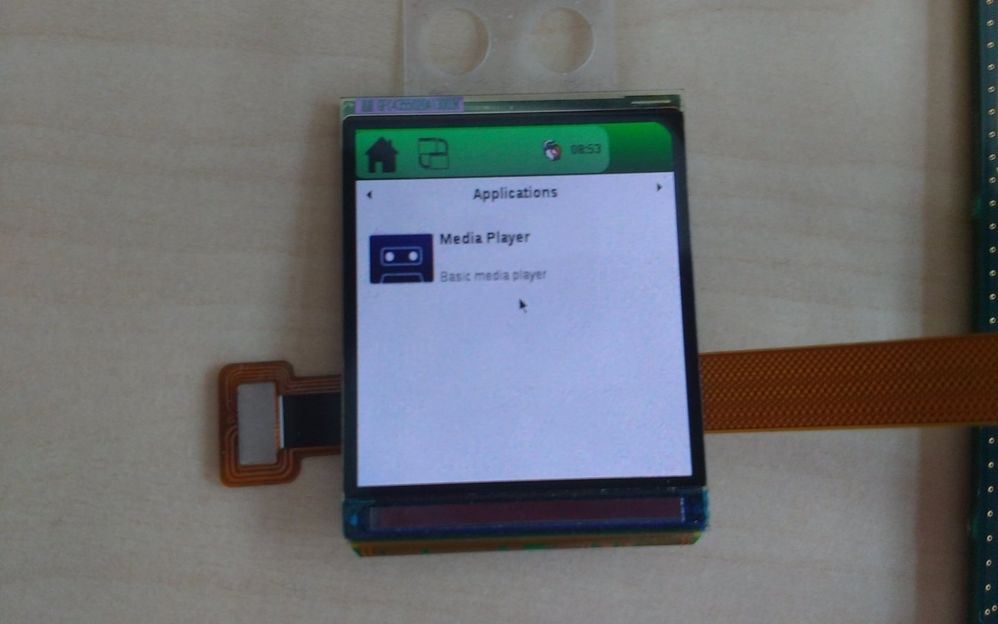

I have written a mipi display driver based on the mxcfb_hx8369_wvga.c driver. And everything works fine when the core-image-sato is used (see pictures below). So I guess it cannot be a problem of my display driver.

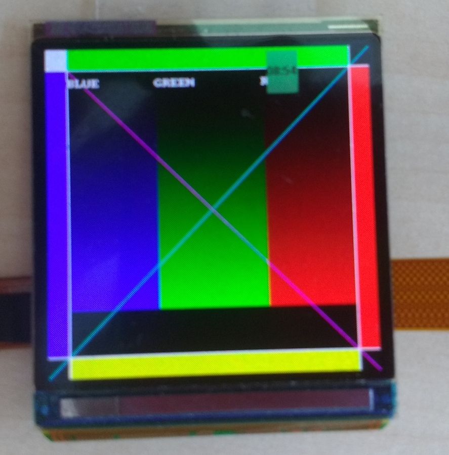

Here the display with fb-test executed.

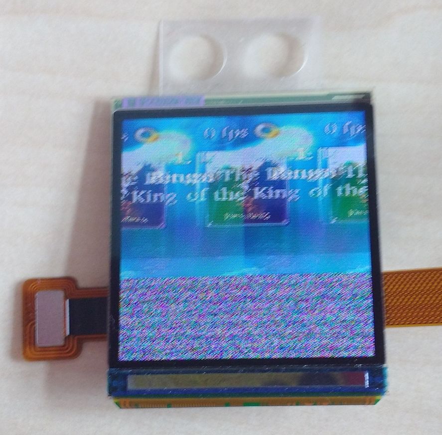

Now the problem is if I use Qt5 with EGLFS the display/frambuffer seems to be configured the wrong way. The display is not completely filled anymore and it seems that image is reduced to half the width and every second line is displayed beside the other half image.
Below is a picture of the display when fb-test is executed:
And another image, were Qt5_CinematicExperience was executed.

It seems that Qt uses a color depth of 12bit and gets this from EGL. How can I modify the color settings of EGL?

Just a update. The problem was in the initialisation sequence of the mipi display in our own driver. The display worked after a blank. This explains why it worked with X because itseems that X does a blank before start.
