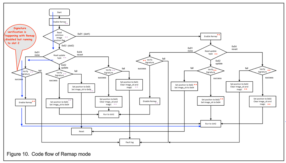

It appears that the Remap flow chart for SBL has some typos and is not the updated one. Can you please provide the correct flow chart?

Please check the highlighted part in the above flow chart. I have marked all blocks where Remap is enabled with "++" and where Remap is disabled to "--"
The enable Remap block in the above flow should be before verification and that is indeed the case in the SBL code.

@kerry zhou Can you please help?

Hi @pm_2552 ,
I hope you're doing well!
What device are you using?
Thank you.
Hector.
6,824件の閲覧回数
pm_2552
Hello I am using RT1060 and this are the docs I am referring to: AN13460
