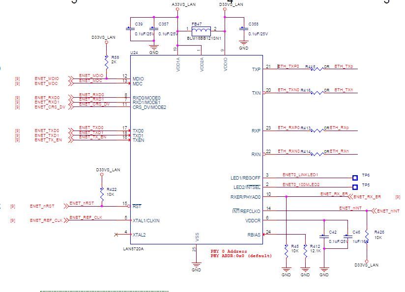

I use LAN8720A and RMII connection to IMX6Q and it works well in kernel 3.10.35,but it does't work in u-boot-2009.08.
when I ping my host,it replies as follows:
MX6Q SABRESD U-Boot > ping 192.168.2.101
ping failed; host 192.168.2.101 is not alive
fec_mii_phy_init: info->phy_addr=0x0
fec_init: info->phy_addr=0x0
FEC: Link is Up 782d
Using FEC0 device
MX6Q SABRESD U-Boot > mii device
MII devices: 'FEC0'
Current device: 'FEC0'
MX6Q SABRESD U-Boot > mii dump
Error reading from the PHY addr=00 reg=00
I can't read or write registers by mii read or mii write,it also replies

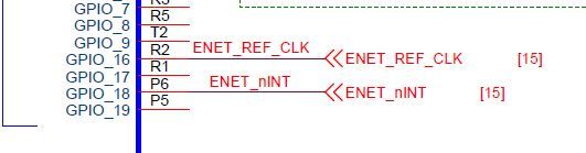

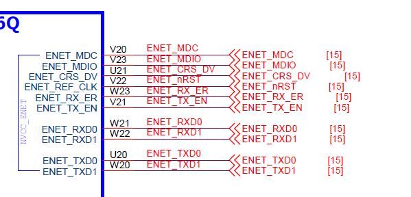

Seen below for my schematic diagram:
and the enet_pads table is as follows:
iomux_v3_cfg_t enet_pads[] = {
#ifdef CONFIG_ENET_RMII
 /* ENET (10/100Mbps enet interface)*/
 MX6Q_PAD_ENET_MDIO__ENET_MDIO,
 MX6Q_PAD_ENET_MDC__ENET_MDC,
 MX6Q_PAD_ENET_CRS_DV__ENET_RX_EN,
 MX6Q_PAD_ENET_RX_ER__ENET_RX_ER,
 MX6Q_PAD_ENET_TX_EN__ENET_TX_EN,
 MX6Q_PAD_ENET_RXD0__ENET_RDATA_0,
 MX6Q_PAD_ENET_RXD1__ENET_RDATA_1,
 MX6Q_PAD_ENET_TXD0__ENET_TDATA_0,
 MX6Q_PAD_ENET_TXD1__ENET_TDATA_1,
 MX6Q_PAD_GPIO_16__ENET_ANATOP_ETHERNET_REF_OUT,
 MX6Q_PAD_ENET_REF_CLK__GPIO_1_23, /* reset phy */

 /* Set GPIO_16 output for RMII reference clock
  * For MX6 GPR1 bit21 meaning:
  * Bit21:       1 - GPIO_16 pad output
  *              0 - GPIO_16 pad input
  * Use interal clock, set GPIO_16 output, and
  * then force input(set SION)
  * Use exteral clock, set GPIO_16 input, and
  * don't set SION bit.
 mxc_iomux_set_gpr_register(1, 21, 1, 1);
I can measure 50MHZ waveform on GPIO_16.The default PHY is for AR8031,how can modify the codes for LAN8720A in u-boot-2009.08?Is there any patches for this?

igorpadykov
Hi SUNNY
please check rmii patch (https://community.nxp.com/servlet/JiveServlet/download/398432-1-274101/MX6_enet_RMII.zip ) on
https://community.nxp.com/thread/304346?commentID=331971#comment-331971
igor
1,825件の閲覧回数
sunnyvan
hi,igor
I've patched it, but it doesn't work. Do you have any other idea about it?
