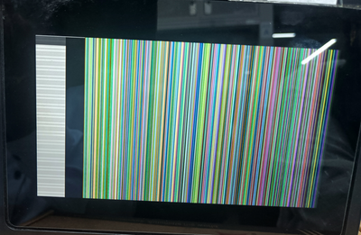

Hi Team, we are able to bring-up the LVDS display on 5.15 kernel on imx8mp custom board, but when we are porting from 5.15 to 6.1 kernel LVDS display is not working.
Below are the panel modifcations added:
With the same below modfications display is working in 5.15 kernel. So need supoort to bringup the display.

Here is the DTS file used:
lvds0_panel {
status = "okay";
compatible = "lxd,m776a";
backlight = <&lvds_backlight>;
enable-gpios = <&gpio1 13 GPIO_ACTIVE_HIGH>;
port {
panel_lvds_in: endpoint {
remote-endpoint = <&lvds_out>;
lvds_backlight {
enable-gpios = <&gpio1 0 GPIO_ACTIVE_HIGH>;
// gpio3_IO23 on lec-imx8mp is display mux
reg_mipi_lvds_select: regulator-mipi-lvds {
compatible = "regulator-fixed";
regulator-name = "mipi_lvds_select_vbus";
pinctrl-names = "default";
pinctrl-0 = <&pinctrl_disp_select>;
regulator-min-microvolt = <1800000>;
regulator-max-microvolt = <1800000>;
gpio = <&gpio3 23 GPIO_ACTIVE_HIGH>;
enable-active-low;
regulator-always-on;
&ldb {
status = "okay";
//fsl,dual-channel;
lvds-channel@0 {
fsl,data-mapping = "spwg";
fsl,data-width = <24>;
status = "okay";
/delete-node/ port@1;
port@1 {
reg = <1>;
lvds_out: endpoint {
remote-endpoint = <&panel_lvds_in>;
&ldb_phy {
status = "okay";
&i2c3 {
touchscreen@41 {
compatible = "ilitek,ili251x";
pinctrl-0 = <&pinctrl_touch_en &pinctrl_touch_rst>;
reg = <0x41>;
interrupt-parent = <&gpio1>;
interrupts = <0 IRQ_TYPE_EDGE_FALLING>;
reset-gpios = <&gpio1 7 GPIO_ACTIVE_HIGH>;
touchscreen-inverted-x;
touchscreen-inverted-y;

after adding the below flags in the panel_desc then display is working as expected
.bus_format = MEDIA_BUS_FMT_RGB888_1X7X4_SPWG,
.bus_flags = DRM_BUS_FLAG_DE_HIGH,
.connector_type = DRM_MODE_CONNECTOR_LVDS,

Chandrasekhar-carrier
hi @joanxie
The Display backlight is initializing but on the display output is coming like below
So unable to figure out what modifications went wrong

joanxie
did you change any source code in the 5.15? did you just use the default lvds driver? as I known, current bsp couldn't support 60Mhz lvds display(single channel) as default, you need change the source code, if you change the 5.15 bsp, did you change corresponding to the 6.1?
