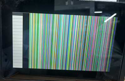

Hi Team, we are able to bring-up the LVDS display on 5.15 kernel on imx8mp custom board, but when we are porting from 5.15 to 6.1 kernel LVDS display is not working.
Below are the panel modifcations added:
With the same below modfications display is working in 5.15 kernel. So need supoort to bringup the display.
drivers/gpu/drm/panel/panel-simple.c | 97 ++++++++++++++++++++++++++++
1 file changed, 97 insertions(+)

Here is the DTS file used:
lvds0_panel {
status = "okay";
compatible = "lxd,m776a";
backlight = <&lvds_backlight>;
enable-gpios = <&gpio1 13 GPIO_ACTIVE_HIGH>;

after adding the below flags in the panel_desc then display is working as expected
.bus_format = MEDIA_BUS_FMT_RGB888_1X7X4_SPWG,
.bus_flags = DRM_BUS_FLAG_DE_HIGH,
.connector_type = DRM_MODE_CONNECTOR_LVDS,

Chandrasekhar-carrier
There are no error messages, but display is not coming as expected
Is there any clock related changes we need to add in 6.1 Kernel?? or any other suggestions.
hi @joanxie
The Display backlight is initializing but on the display output is coming like below
So unable to figure out what modifications went wrong

joanxie
did you change any source code in the 5.15? did you just use the default lvds driver? as I known, current bsp couldn't support 60Mhz lvds display(single channel) as default, you need change the source code, if you change the 5.15 bsp, did you change corresponding to the 6.1?
7,064 Views
We didn't do any bsp changes except the panel detail structures are added in 5.15 kernel. So did the same modifications in the 6.1 kernel as well
7,030 Views
joanxie
do you mind dumping the clock to check? could you get the correct clock for your lvds panel, I checked the ldb driver, I don't find anything change would affect your display
7,096 Views
joanxie
what do you mean "not working"?do you get anything error messages?
