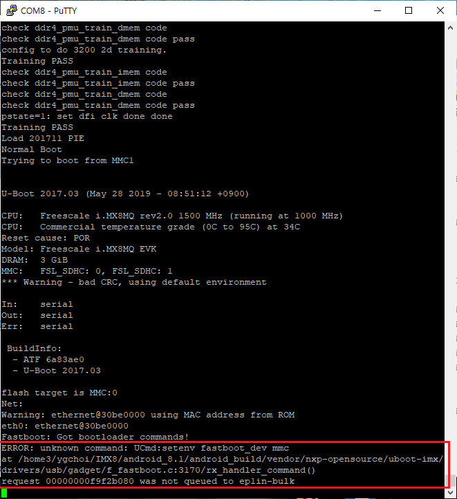

Hi communicators.
I found something wrong bug to step by step Porting to Android.
And it's a problem occurred during execution:
Doc Download URL:
https://www.nxp.com/docs/en/supporting-information/android_Q10.0.0_1.0.0_docs.zip
And the name of the document I read: Android_Quick_Start_Guide.pdf
My OS is Windows10 x64
and, I installed uuu.exe
and, code from executing:
.\uuu_imx_android_flash.bat -f imx8mm -a -e -u trusty
and error found.
Client CMD (windows10)
NXP i.MX8MQ serial CMD
What the unknown command  "setenv fastboot_dev mmc"
U-Boot 2017.03 (May 28 2019 - 08:51:12 +0900)
CPU: Freescale i.MX8MQ rev2.0 1500 MHz (running at 1000 MHz)
CPU: Commercial temperature grade (0C to 95C) at 41C
Reset cause: POR
Model: Freescale i.MX8MQ EVK
DRAM: 3 GiB
MMC: FSL_SDHC: 0, FSL_SDHC: 1
In: serial
Out: serial
Err: serial
BuildInfo:
- ATF 6a83ae0
- U-Boot 2017.03
flash target is MMC:0
Net: eth0: ethernet@30be0000
Fastboot: Got bootloader commands!
ERROR: unknown command: UCmd:setenv fastboot_dev mmc
at /home3/ygchoi/IMX8/android_8.1/android_build/vendor/nxp-opensource/uboot-imx/drivers/usb/gadget/f_fastboot.c:3170/rx_handler_command()
request 00000000f9f2f7c0 was not queued to ep1in-bulk

Hi Lim,
1. You have to figure out whether your board is I.MX8MM or I.MX8MQ
Your command: .\uuu_imx_android_flash.bat -f imx8mm -a -e -u trusty
But in your screenshout, iMX8MQ is used.
2. the link is for hardware connections.
When the imx8mmevk enter ino the download mode ,it report the error
3. the link is for i.MX8MQ , and for i.MX8MM, you can also refer to it.
https://community.nxp.com/docs/DOC-342719
Hope above information is helpful to you.
Have a nice day!
B.R,
Weidong

elim
Thanx.
it's solved
problem is 2th.
I booted booting Mode of booting Switch. not Download Mode.
:smileyhappy:
