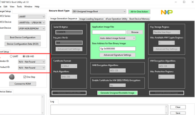

sapirbuz
Our board can't work. We connect the USB host or the SWD NXP debugger and nothing happens.
When we connect our board with the NXP to the host, the NXP MCU Boot Utility doesn't recognize the flash, but when we connect the EVKB with the same flash, it is recognized automatically, and we see device connected on the device manager.

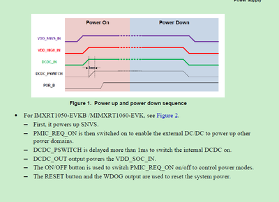

  Please check two points:
1. POR sequence
DCDC_PSWITCH is delayed more than 1ms to switch the internal DCDC on, this is the must.
2. Do you have JLINK, you can use the JLINK to check with SWD, whether you can find the M7 core or not?
If the M7 core is not detected, it means your hardware have issues.
Kerry

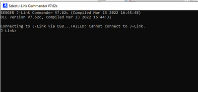

1. DCDC_PSWITCH is delayed 8ms to switch the internal DCDC on.
2. We have SWD debugger, should it work the same as JLINK?
Sapir
21,219件の閲覧回数

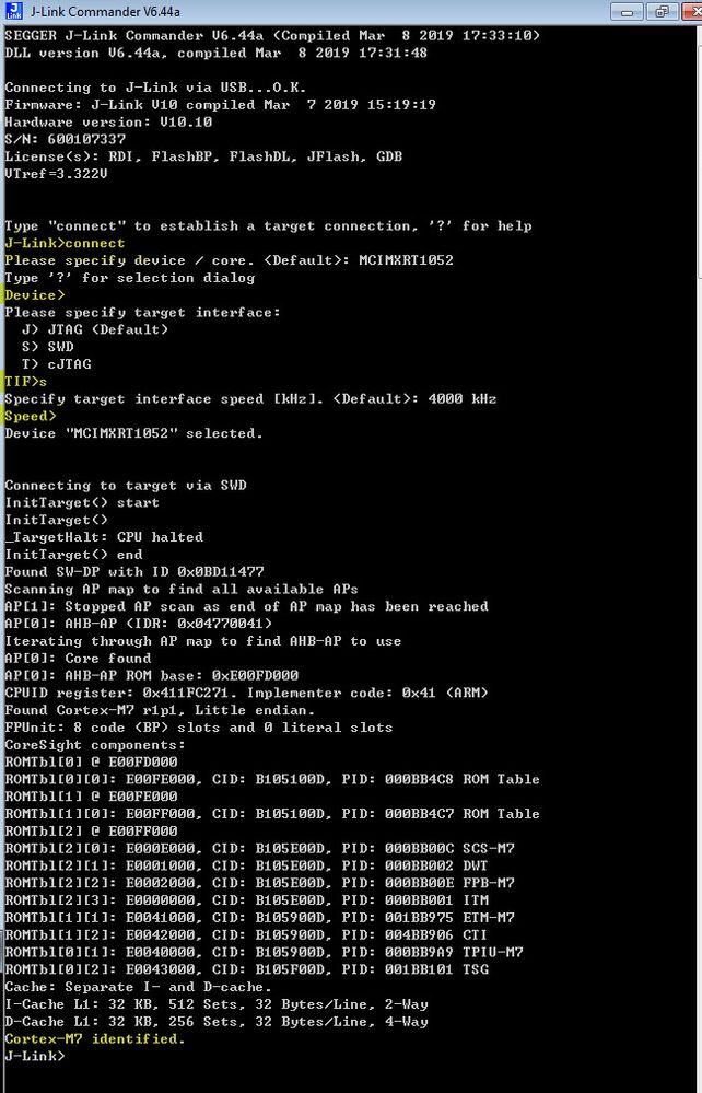

kerryzhou
Hi @sapirbuz
=>Kerry: it's enough!
=>Kerry: SWD is the interface, the JLINK connect interface is SWD, so you can try to use the JLINK connect to the RT board SWD interface, then use the JLINK commander to test it, something like this:
JLINK commander can find in the JLINK driver.

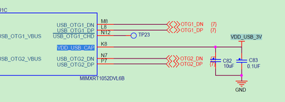

sapirbuz
Thank you!
I found the problem in the design: the VDD_USB_CAP is shortened to VDD_SOC_IN.
Can I know if anything may be damaged if the VDD_USB_CAP pin will be float (and not connected to capacitor)

kerryzhou
Hi @sapirbuz ,
  Thanks for your information.
  1. JLINK connection result
     That is not correct, you need to check the SWD connection between your board the JLINK, seems connection have issues.
   If you still have issues, you can share me your connection photo!
2. the USB issues
I don't think your chip is damaged, please remove the VDD_SOC_IN from VDD_USB_CAP.
VDD_USB_CAP should like this:
After the modification, can you find the USB or not in the serial download mode?
Any updated information, kindly let me know.

sapirbuz
i don't have the option to connect the VDD_USB_CAP to external capacitors.
Is that critical? or can the MCU work properly without those capacitors?
21,098件の閲覧回数
kerryzhou
Hi @sapirbuz ,
 For testing, I think, you need to remove the VDD_SOC_IN from VDD_USB_CAP at first, then try it if you can't add the capacitor. the capacitor is a must if you design the product, but for the simple testing, you can leave it as float at first.
Wish it helps you!
Kerry

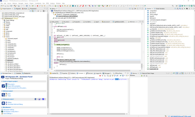

sapirbuz
We succeed in connecting the debugger using the MCUXpresso IDE.
The USB is still not recognized.
What can we do to debug the problem using the MCUXpresso IDE?
Should we program something before the USB is recognized? or should it be recognized automatically on a "clean" MCU?
BDY, the detection failed using the Jlink commander
21,315件の閲覧回数
sapirbuz
When we connect our board with the NXP to the host, the NXP MCU Boot Utility doesn't recognize the flash and nothing happens.
But when we connect the EVKB with the same flash, it is recognized automaticall.
