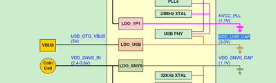

We have MIMXRT1051CVL5B on our design.
the MCU SNVS and 3.3V rails are in the required range, the clocks are ok, but we can't see a device connected (on the SW or device manager) while we connect the USB host to J16 connector or the NXP debugger to J3 connector.
I have attached our design. Can you please review and let us know what can be the problem?

sapirbuz
Thank you!
I found the problem in the design: the VDD_USB_CAP is shortened to VDD_SOC_IN.
Can I know if anything may be damaged if the VDD_USB_CAP pin will be float (and not connected to capacitor)

kerryzhou
Hi @sapirbuz ,
  Thanks for your information.
  1. JLINK connection result
     That is not correct, you need to check the SWD connection between your board the JLINK, seems connection have issues.
   If you still have issues, you can share me your connection photo!
2. the USB issues
I don't think your chip is damaged, please remove the VDD_SOC_IN from VDD_USB_CAP.
VDD_USB_CAP should like this:
After the modification, can you find the USB or not in the serial download mode?

sapirbuz
i don't have the option to connect the VDD_USB_CAP to external capacitors.
Is that critical? or can the MCU work properly without those capacitors?
21,206 Views
kerryzhou
Hi @sapirbuz ,
 For testing, I think, you need to remove the VDD_SOC_IN from VDD_USB_CAP at first, then try it if you can't add the capacitor. the capacitor is a must if you design the product, but for the simple testing, you can leave it as float at first.
