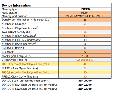

Hi Everyone,
I would like to ask a simple question. I did a DRAM calibration to the LPDDR4 DRAM on my custom designed imx8m mini board and when I checked the GUI log I didn't see any 'point0@1500MHz' text at the time of stress test. Can you check the file and tell me if there is any problem? I have attached the log file for your reference.

Your script seems to be ok and also you are passing the test, I do not see any issues.
These set points are defined on RPA file:
Those the values should remain as are and should not be modified. In these cases, the settings are provided for completeness.

This is defined on RPA file to generate the script, please verify if point0@1500MHz is included.

Yes, I think the script includes point0@1500MHz but sorry I am very new to DRAM calibration. I have attached the script I used for your reference.
