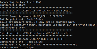

Hi team,
we had designed a MIMX8ML8DVNLZAB custom-board tested all peripherals, except JTAG.
1)MCUxpressoIDE is not supporting for imx8 SDK in windows or Linux platform.
2)we are aware that JTAG can able to flash on CM7 controller.
can you guide us to flash a demo application to test the working of JTAG interface.

ManikantaRobbi
Hi team,
Thanks for response, but we are getting error msg as below:
please help me to solve this in i.mx8 plus.
Thanks & Regards,
Manikanta Robbi

ManikantaRobbi
Hi team,
we are facing the issue still, please provide us with stepsstep User manual to flash a demo application in in MIMX8ML8DVNLZAB.
And let us know more info about which mode it can operate (JTAG,CJTAG, or SWD), V.ref=3.3V or 1.65, and what are necessary steps need to be taken.
Thanks and regards,
Manikanta Robbi.
