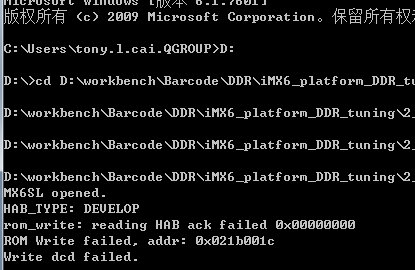

tony_l_cai
The following picture is the operation after DDR stress tool testing:
and could you tell me some possible reasons?

igorpadykov
Hi tony
for new problem/qustion new thread should be
created.
Thanks !
~igor
