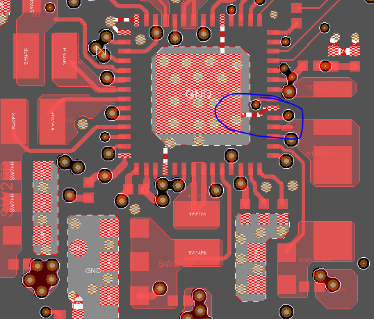

Hi Team
As  per  application notes  AN4717  pin no 48 of  PF100  is  GND  reference it should  be  keep away from high switching GND  reference  path
But in layout  file  it is  connected  to GND  EP. Should  i caonnect this with GND  EP  or  connect to GND plane
through separate via.

Hi Abhishek
example of connection of pin no 48 of  PF100 can be found in  iMX6Q-SABRE-SDB-DESIGNFILES
Design files, including hardware schematics, Gerbers, and OrCAD files for i.MX 6Quad (i.MX 6Dual emu...
igor
