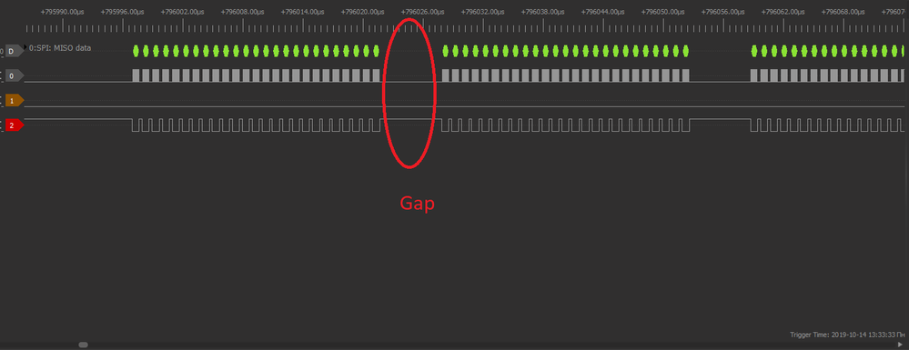

Dear all,
I use a spidev device to write 200 bytes to spi.
Why are there gaps between every 25 bytes?
How to remove this gaps?

Hi Renat
one can try to adjust BURST_LENGTH value of register ECSPIx_CONREG. If
this will not help, seems delays are caused by processor internal bus latencies
and unfortunately there is no way to change this.
