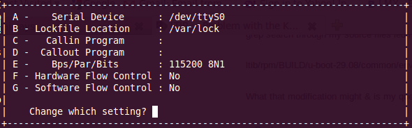

double check your minicom (or screen) configuration:
http://www.imxdev.org/wiki/index.php?title=All_Boards_Serial_Console
make sure you´re using the right serial device.
Are you using VMWare image?????????????????????

Hm, looks good. Did you try with another serial cable? In the end, it might be there's something wrong with the board you have, might we worth checking signals with oscilloscope if you have that or then replace the board...
It's very unusual if you can't get any serial communication with u-boot.
What if you just type "printenv" and press enter? (not sure if local echo needs to be enabled, but I don't think so...)

KrishnaPavan
Fresh Out Contributor
8,620 Views
VladanJovanovic
there's something wrong with your serial port setup or cable. Can you post a snapshot of your serial console settings in PC you're using?
