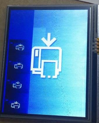

I am in trouble,
the RGB LCD display logo is normal in uboot and kernel, but the LCD flash 4 small images when from uboot to kernel about 300ms when starting kernel. the port of LVDS0_DATA0,LVDS0_DATA1,LVDS0_DATA2 have abnormal signal, but the port of LVDS0_CLK is normal through the Oscilloscope.
 I use  I.MX6DL over LVDS port connect to TM035KBH02 transform RGB signal to 320x240 LCD.
My Linux environment is 4.1.15
I don't know what config is incorrect when start kernel, so i need some help, thanks a lot.

Hi Ganbo
please try patches from

ganboshi
Hi igor
Thanks for your support, I have fix my problem after use the 4.1.15 patch.
