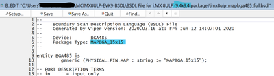

I have been following AN13215 to perform a boundary-scan proof-of-concept with the specified Lauterbach devices/sw, but have a few issues.
I downloaded the iMX8ULP BSDL files, but noticed that the two files are switched. We are using the 15x15 package which supposedly corresponds to the IMX8ULP-BSDL.zip file, but the file that matches it(and the GPIOs) is actually in MCIMX8ULP-EVK9-BSDL.zip:
It makes sense that we want the EVK file as the 15x15 is on the EVK.

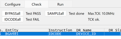

I then proceed with the correct file, following the steps in the application note, and get stuck when the IDCODE is incorrect:
I was however able to successfully SAMPLEall and BYPASSall:
Can the files be corrected and can we have a file with the correct IDCODE?

Hi @Bio_TICFSL ,
The IDCODE is the BSDL had the incorrect version. I changed it from "0000" to "0001" and now it now passes the IDCODE check.
