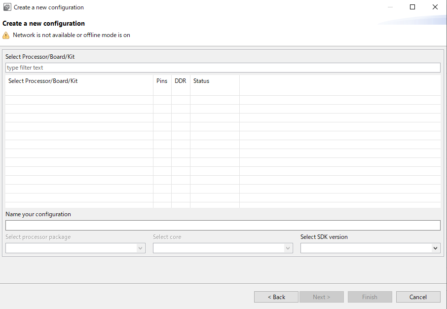

therefore, I would like to import processor data from other PC.
I have successfully done processor data exporting as attached file.
But, I could not import these data. Could you please teach me procedures to import data?

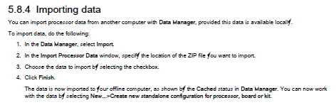

(1) Importing procedure
I have tried according to following user guide.
(2) Error description
After import data, I've tried create a new configuration. but, I could not find any data on the window as shown in the capture below.

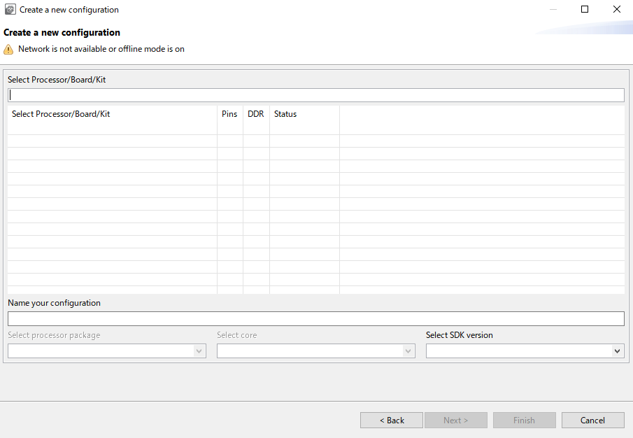

Dear Aldo,
I appreciate your support.
unzip the file in the following folder:
C:\nxp\i.MX_CFG_v7\mcu_data
<before unzip, following files stored.>
- resources
- offline_data.zip
<after unzip, following files stored.>
- resources
- offline_data.zip
- boards
- components
- processors
- ksdk2_0_info.xml
- npidata.mf
Unfortunately, I could not solve this issue by your workaround.
Should I need some more steps?
Kazuma Sasaki.

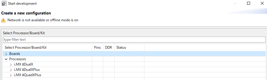

Yes, please note that it is a different folder, please try to unzip in the following folder:
C:\ProgramData\NXP\mcu_data_v7
Aldo
2,794 Views
Kazuma_Sasaki
Senior Contributor I
Dear Aldo,
I am sorry for my wrong operation.
Finally, I could import data correctly. Thank you so much.
