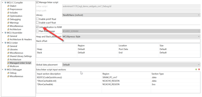

I'am trying to run an SDK example (evkmimxrt1170_lvgl_demo_widgets_cm7) on imxrt1176 evk board, from the external ram SDRAM.
here's my config :
The example crash with this conf, did someone have an idea about that ?
Another question, when running the app from SDRAM can i debug through CMSIS-DAP linkserver or with PE Multilink ?
Regards.

Hi @ahmedhrabi ,
Firstly, regarding the MCU settings, just clicking the Link application to RAM is enough, further, follow the post to set up the script to enable the debug in the SDRAM.
TIC

Hi @jeremyzhou,
It works. Thank you for your support.
