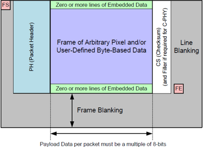

I also have question on  CSI_CSIFBUF_PARA  register setting.
To my application, image has no interlaced mode, so the driver (mx6s_capture.c) set to 0.
But according to IM8M RM, this register should be set to show how many double words to skip before starting to write the next row of the image.
 I don't know whether it is required to set this , if yes, how to decide the FBUF_STRIDE value. Our image frame is as below figure:
