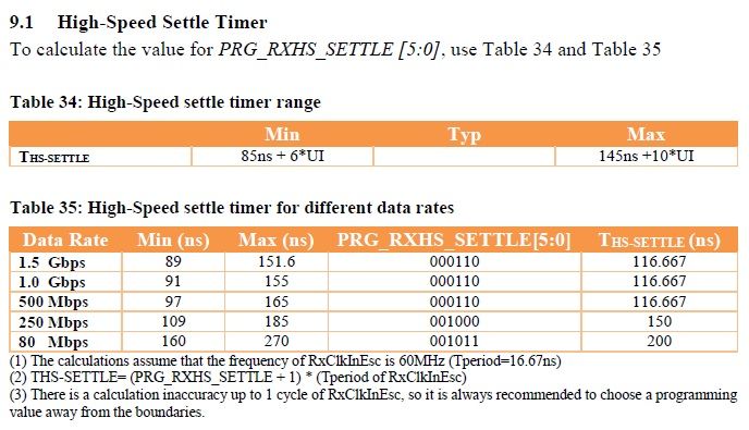

qiang_li-mpu_se
iMX8M MIPI CSI2 PHY is different to iMX7D.
For iMX8M CSI2_1_S_PRG_RXHS_SETTLE setting, please reference to followed table:

We're currently also in the progress of starting up the MIPI-CSI2 interface (not using any Linux) on an i.MX8QM, and are struggling (again) with the very unclear documentation (or absence of it).
We have a few questions:
1) Where can we find the referenced tables 34 and 35; is this from some other i.MX8 reference manual, or application note, or an NXP internal document?
2) When reading the NXP AN13573 document, we were under the impression that "UI" was the period of the clk_ui, being the outgoing pixel clock of the MIPI block (pixel link as such)? Even though that we're wondering if this was making any sense; since this pixel clock has nothing to do with the D-PHY. However, the referenced table 35 uses for UI the period of one bit time (bit rate) on the MIPI lane(s), which seems to make more sense. Can it be confirmed that AN13573 is incorrect in the example shown in 6.1.5 (or is at least very misleading), where for UI rather the SoC generated clk_ui period is used which doesn't have a direct relation (and is even not in the same order of magnitude) with the bit rate on the MIPI lane(s)?
3) We only have one MIPI-CSI2 lane being used today, but in case we would have 2 or 4 lanes, what would be the impact on the setting of S_PRG_RXHS_SETTLE? If the setting is related to the lane bitrate, the setting should be the same for more lanes if the MIPI lane frequency is still the same? If the setting is indeed related to the generate clk_ui pixel clock, then the setting should change because there are more pixels to transfer within a given time period, hence a shorter pixel time? Which one of the options is correct?
Thanks.

I can see how that table shows how to calculate Ths_settle (in ns) for any given data rate. How exactly do the register bits then relate to that value?
sorry in case I overlook something obvious. thank you in advance.

please also see how the mainline driver calculates hs_settle from the lane rate and esc clock: https://git.kernel.org/pub/scm/linux/kernel/git/torvalds/linux.git/tree/drivers/staging/media/imx/im...

Gents, I can't make any sense whatsoever out of this table:
1.  On the IMX8M, there is no 5-bit  "PRG_RXHS_SETTLE" parameter referenced anywhere in the IMX8M reference manuals.  Rather, there's a 7-bit HS_SETTLE parameter (bits 31-24 in the MIPI_CSI_DPHY_COMMON_CTRL register, see section 13.4.15.8 in the IMX8MMRM reference manual, revision 2.
2.  In Table 34 above, THS-settle is defined with a min value of 8ns + 6*UI.  What is "UI"?
3.  What is RxClkInEsc?  I can't find that term anywhere in the IMX8MMRM manual either.
4.  If we're running a data rate that is between the discrete Data Rate values listed in Table 35, do we interpolate an HS_SETTLE value?
A general comment to the support staff: your life will get MUCH easier if you can cajole NXP engineering into properly documenting the CSI2 and Bridge modules.
Thanks to anyone who can answer any of the above questions!
John

qiang_li-mpu_se
Hi John,
The above table 34 and Table 35 are for iMX8MQ, not for iMX8MM. The iMX8MM MIPI CSI2 should reference to iMX7D's.
Table for HSSETTLE[7:0] and CLKSETTLECTL[1:0].

john_obendorfer
Thank you for the clarification!
The "MIPI serial clock frequency" in the first column: is that a) the MIPI_CSI_CLK_ROOT frequency, or b) the MIPI clock lane frequency?  On our board, the device tree parameter "clock-frequency"  is set to 333MHz, while the MIPI clock lane is running at 1.188GHz.  I think the value I want to use in the table lookup is 333MHz, but thought should ask ...

qiang_li-mpu_se
Hi John,
It should be the MIPI clock lane frequency * 2. So it follows the external MIPI CSI2 input signal. You don't need change the CPU internal MIPI_CSI_CLK_ROOT.

robrechtbisscho
Thank you for your answer. But it is still not clear to me however. In your table there is only the value 0 for CLKSETTLECTL while in the device tree value 2 is used.
I also assume that de MIPI clock in the table you provide is DDR? So when i measure a MIPI clock of 112MHz using a scope i would have to actually use 224MHz in the table?
I can not seem to map the used values in the device tree to the values in the table.
43,540 Views
qiang_li-mpu_se
The table is for DDR mode, so your setting 224MHz is OK.
The CLKSETTLECTL setting is not important, the old BSP hasn't set it, just used the default register value 0.
