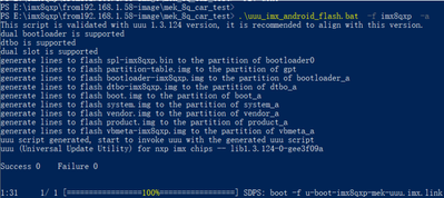

Cannot use USB 2.0 to download image
Stuck in this position
