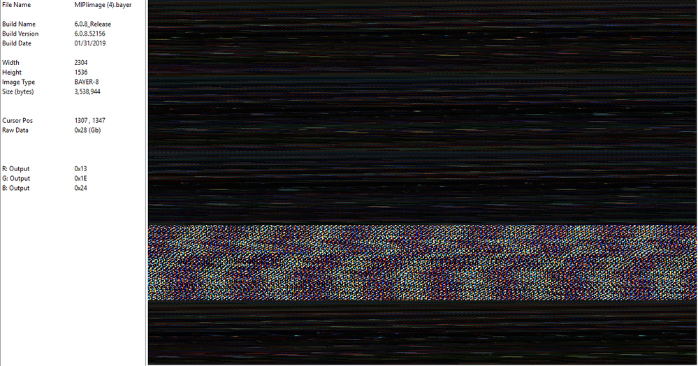

Update:
Here is the image I get, with the shown resolution (2304x1536 - RAW8) with 2 lane configuration. I set up the sensor to output on 2 lanes, as that way the MIPI clock is in range for the CSI2 receiver (83.4 MHz).
igorpadykov
To your point above, I tried to use the driver "fsl,mxc-mipi-csi2", however, that dies on loading saying it can't find
Failed to get mipi CSR register
So I assume that version of the driver is incompatible with the MIPI-CSI2 receiver in the iMX8M.
I switched back to the
compatible = "fsl,mxc-mipi-csi2_yav";
However, there the hs-settle devicetree parameter gets ignored for whatever reason. It seems to be hard-coded, so I modified the following in 'mxc-mipi-csi2_yav.c':
#define GPR_CSI2_1_S_PRG_RXHS_SETTLE(x) (((x) & 0x3F) << 2)
//Hard-code HS_SETTLE to 0x01 -> 80-90MHz pixel clock
static u8 rxhs_settle[2] = { 0x01, 0x01 };
        regmap_update_bits(csi2dev->phy_gpr.gpr,
                 csi2dev->phy_gpr.req_src,
                 0x3FFF,
                 GPR_CSI2_1_RX_ENABLE |
                 GPR_CSI2_1_VID_INTFC_ENB |
                 GPR_CSI2_1_HSEL |
                 GPR_CSI2_1_CONT_CLK_MODE |
                 GPR_CSI2_1_S_PRG_RXHS_SETTLE(csi2dev->
                                hs_settle));
(I modified only the values, the other things I just copied here to show where it gets used)
My current .dtsi file looks like this (even though I think those values get ignored in the driver)
        mipi1_sensor_ep: endpoint1 {
                                    remote-endpoint = <&ar0330_mipi1_ep>;
                                    data-lanes = <1 2>;
                                    csis-hs-settle = <1>;
                                    csis-clk-settle = <0>;
                                    //csis-wclk;
And it comes up with:
root@b0sample:~# dmesg | grep csi
[ 1.703847] mxc-mipi-csi2_yav 30a70000.mipi_csi1: mipi_csi2_probe
[ 1.708724] CSI: Registered sensor subdevice: mxc-mipi-csi2.0
[ 1.713215] mxc-mipi-csi2_yav 30a70000.mipi_csi: Remote device at /mipi_csi1@30a70000/port/endpoint1 XXX found
[ 1.721934] mxc-mipi-csi2_yav 30a70000.mipi_csi1: lanes: 2, name: mxc-mipi-csi2.0
[ 3.904325] mxc-mipi-csi2_yav 30a70000.mipi_csi: Registered sensor subdevice: ar0330 3-0010
I did not mention yet,but the command I use to capture the data is:
v4l2-ctl --set-fmt-video=width=2304,height=1536,pixelformat='BA81' --stream-count=1 --stream-to=MIPIimage.bayer --stream-mmap=5
The allocated video buffer is correct, and the file size is as expected.
I have attached the raw incoming data as well, if you want to take a look what's coming in with these settings.

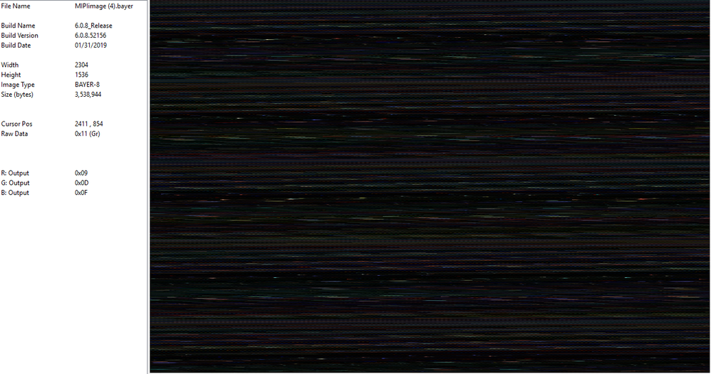

What's even more odd, is that If I change the .dtsi to this:
&csi1_bridge {
    fsl,mipi-mode;
    //fsl,two-8bit-sensor-mode;
    status = "okay";
    port {
        csi1_ep: endpoint {
            remote-endpoint = <&csi1_mipi_ep>;
            data-lanes = <1 2>; <-- CHANGE RIGHT HERE (WHY!?!?)
&mipi_csi_1 {
    #address-cells = <1>;
    #size-cells = <0>;
    status = "okay";
    port {
                                    data-lanes = <1 2>;
                                    //csis-wclk;
        csi1_mipi_ep: endpoint2 {
                                    remote-endpoint = <&csi1_ep>;
Then I get a different image:
Which leads me to believe that maybe the problem is between the MIPI-CSI2 and the CSI interface ?!

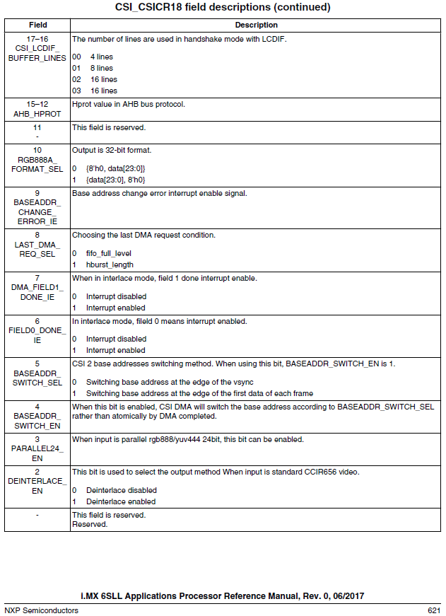

Are you entirely sure that the iMX8M uses the same CSI IP as the iMX6SLL?
In the RM for imx6sll, (which is using the same IP and linux driver) the following chapter describes the IP.
"16.4.1 Data Transfer with the Embedded DMA Controllers".
I'm decoding the driver right now, and almost none of the bits match up...
Just a quick example:
CR18 register from the iMX6SLL Datasheet:
While the driver sets the data format in this register:
    case V4L2_PIX_FMT_SBGGR8:
      cr18 |= BIT_MIPI_DATA_FORMAT_RAW8;
Where:
#define BIT_MIPI_DATA_FORMAT_RAW8   (0x2a << 25)
Which matches up with the iMX7D datasheet for whatever reason...
It's starting to get more than confusing at this point.
Thank you in advance

To your question "What do you see exactly? do you have an partial image captured? "
It's correct, when I set 2 lanes -> Half the pixels come in
If I set 4 lanes -> I get 1/4 of the image

julien_jayat
I was asking about the sensor part.
You answered it. IMX8M doesn't support the Virtual Channel.
For 2 lines configuration:
Do you see
1. continuous pixel/ missing pixel
2. valid top half of the frame and missing bottom half
1.  would make me think of problem in the capture side.
2. would make me think of configuration problem between the MIPI CSI Rx and the CSI capture engine.

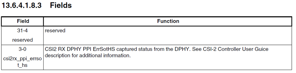

On another note, the area you referenced in the iMX8M RM, the register map references another document I cannot find:
Is this "CSI-2 Controller User Guide" available somewhere?
