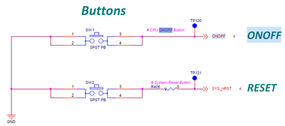

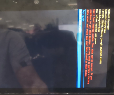

Hello NXP,
1.When the device is turned on, pressing ONOFF does not trigger the Power Key pop-up window.
2.After multiple on-off pin power-on and power-off operations, the system failed to start normally.The situation shown in the following picture occurs.

Zhiming_Liu
Hi @brady3
Please check the andoid log for crash or error related logs, NXP Android is for EVK hardware, please compare the hardware differences, it may be that some hardware does not exist on your board, but PowerManagerservice is still trying to operate.
Zhiming

Zhiming_Liu
Also no issue on Android13. This issue  you mentioned could relate to hardware design.
There is no resistor between SW button and ONOFF IO.
Zhiming
3,266 Views
brady3
Even after I removed the resistor, the above phenomenon still occurred. I want to know if this on/off requires software control. If not, how can I troubleshoot hardware issues?
Best Regards
3,245 Views
Zhiming_Liu
The ONOFF driver is drivers/input/keyboard/snvs_pwrkey.c
You can check if there is a problem by looking at the button waveform.
Zhiming
3,106 Views
brady3
  I added this driver and the pop-up window problem has been solved. However, the factory reset problem still exists. Do you have any good troubleshooting suggestions for this?
Best Regards
3,095 Views
Zhiming_Liu
Hi @brady3
Zhiming
