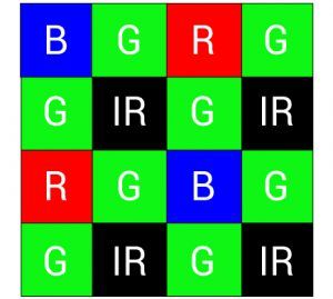

Dear Community,

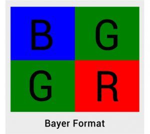

I would like to know if the ISP inside IMX8MP supports demosiacing RAW RGB-IR sensors which seem to have different pattern of Color Filter Array (CFA) compared to RAW Bayer, please ?
Standard Bayer Pattern :
RGB-IR filter pattern :
Figure-2-RGB-IR-filter-pattern-08-300x269.jpgFigure-2-RGB-IR-filter-pattern-08-300x269.jpg
Thanks in advance and best regards,
Khang

@khang_letruong,
I received confirmation. "Yes, this is a HW limitation, 8mp ISP doesn’t support RGB-IR. It can only support Bayer RGB or Monochrome."

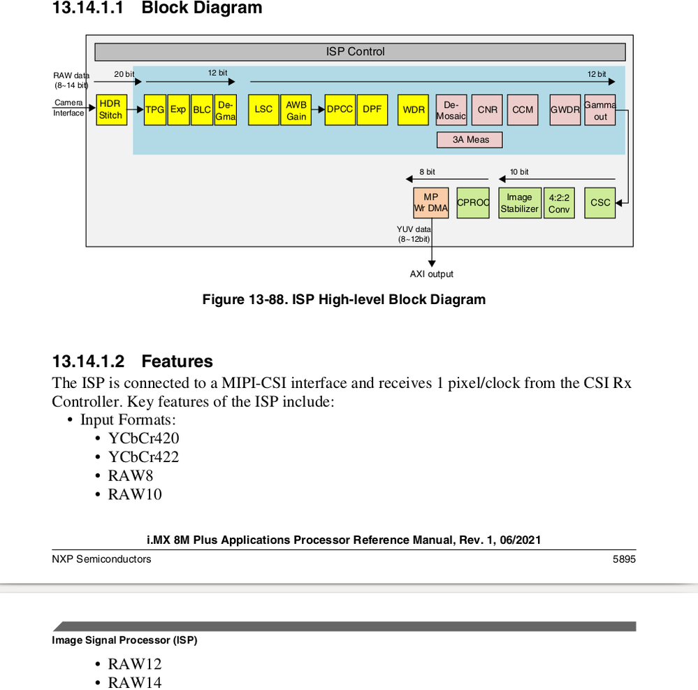

Hi Again,
From the Reference Manual of iMX 8M Plus, it seems that RGB-IR is not in the list of supported input formats :
Could someone confirm, please ?
K.
