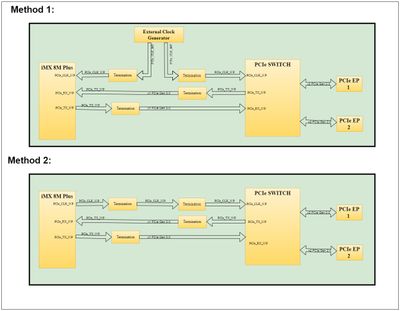

Could you please brief about the purposes of using external PCIe clock generator used in the EVK board.
In our design we are planning to avoid external clock generator(9FGV0241AKLF) due to BOM optimization. So IMX 8M plus will act as a root complex device. So what will be the clock type from NXP processor?
and can we meet the standard PCIe clock requirement for the PCIe gen3.0 x1 Lane interface without using the external PCIe clock generator?

Termination/differential signal standard used in MIMX8ML6CVNKZAB
We are interfacing NXP with a PCIe switch(PI7C9X3G606GPBFCA) without using external clock generator.
So, what will be the differential signal standard? is it HCSL?
And is it required to provide any kind of termination at driver side(NXP)?
Can we get some reference document to know the differential clock type used?
For providing the termination at endpoint(PCIe Switch) we need to know the more information about the differential clock type available at the source(NXP i.MX 8M Plus) side. Please guide to us.

On EVK, a PCIE clock generator chip (9FGV0241) is used to feed high-quality clock to both the PHY and connecter/device. If a PCIE clock generator is not available, use the internal clock of the chip. Note that the internal clock exhibits larger jitter than that from PCIE clock generator

Hi @JosephAtNXP
Attaching our use case.
Use CaseUse Case
1) So which PCIe clock method is suggesting for us based on our use case?
PCIe ClockPCIe Clock
2) Which termination is suggesting for the PCIe clock?
Our concern about the clock is if we proceed with the method 2, then need to know about the clock type...then only we can provide corresponding clock termination/transformations. Refer the attached application note for this query.

As said, you can use internal clock or external clock in any application just considering that there may be a larger jitter, this increment can be in any application, and as you may see in schematics, there are no clock termination requirement, check that if internal clock'd be used, map M2 pins to processor pins.
