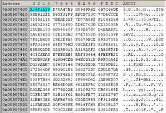

Hi all,
I have a IMX6UL custom board with NAND flash,and bsp version is YOCTO L4.14.98.
I can burn bsp into flash with uuu tool,and the board can boot to linux user space from serial download mode.
But it can't boot from NAND flash.
After the board power up, I checked address 0x907400,which IVT header should showed there:
It seems that ROM can't fail to get IVT.
