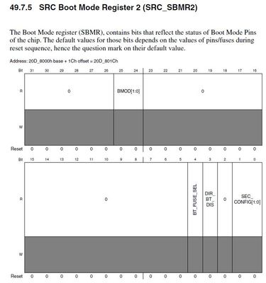

I checked SRC_SBMR registers with DDR test tool and values showed below:
Boot Configuration
SRC_SBMR1(0x020d8004) = 0x00000890
SRC_SBMR2(0x020d801c) = 0x02000041
IMX6ULRM:
The SRC_SBMR2[6] should be 0 but there is 1 on my board.
Did this bit mean something wrong?
