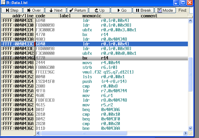

Hello *,
I'm trying to debug imx53 in early stage, but seems that the ROM loader get some issue, the code run in loop in memory at 40xxxxh and in Bxxh, so as in the IMX53RM.pdf page 483, at c0h-3fffh and 400000h-40bffh there is the ROM Bootstrap.
With the scope I see some data on NAND bus.
I tried also to follow this guide, with this u-boot (2014-10) code:
http://www.denx-cs.de/doku/?q=m53evkcompileinstalluboot
after this I use this command (whit my kernel that work good with nand):
umount /dev/mtdblock*
umount /rwfs/
ubidetach -d 5 /dev/ubi_ctrl
mount
mount /dev/mmcblk0p3 /mnt/cdrom/
sleep 3
echo 1 > /sys/devices/platform/mxc_nandv2_flash.0/ignorebad
kobs-ng init -v  /mnt/cdrom/u-boot-with-nand-spl.imx
In the first part I umount all nand partition, mount external sdcard, where is located nand-spl.
My nand is also on PATA pins, the only change is that my UART is on UART1, so I changed the iomux.
2,154 Views
skrausse
Hello Cristian,
At least you should try to sue this sequence to connect to the baord:
  SYStem.RESet
  SYStem.CPU IMX535
  SYStem.Option ResBreak OFF
  SYStem.Option WaitReset 100ms
  SYStem.Up
The chip does not allow to connect to the board in an early boot stage, because the debugger has to wait, till the debug clocks internaly are enabled. Important at this stage is, that they later will nto be disabled again by the bootloader (there were some versions, were debug debug port was disablked completely).
If this is not working, then it would be good to know, what error messages you get. You can try to connect in a later boot stage using Attach instead of Up, just to see, if debugging is possible at all. If you were not able to connect in any case, then you could try to select a different boot mode, just for testing.
Steffen.
