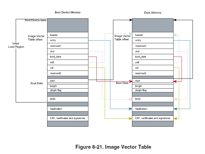

So i shifted to booting from sd card, and the boot rom works fine, loads the 1st 4k into on chip ram and then initializes the dram, but it wont jump to the start address of the image, I used jlink to set the program counter to that start address of the image and it worked. Now how can I make the bootrom jump to the start of the image, from all the documents that I ve read it says that the BootRom should jump by itself to the address given in the IVT...
Attached is my bin file, the image is placed at 0x27800780...

Oh I should tell you my understanding so far, so I thing if I add an IVT in front of my desired image it will make the the image bootable and thus load the image on the desired location specified in the IVT, so I think if I flash this raw image with an IVT on spi nor, and since the default boot setting is to nor, the boot rom will read the raw IVT values and load the image to the desired location and start running the image.... let me know if there is anything wrong with my thought process.

BiyongSUN
IVT is the information for ROM code to locate the image to me memory, which is like jlink use the elf format image.
That make all the segments such as .TEXT as our wish.
That is why called IVT(Image Vector Table). That is what Vector's meaning.
ROM need read that IVT(aslo the boot data) from a special offset.
That is why need put image with a offset.
The reference manual has very very detialed description.

Yes I ve read about that, this means my understanding is correct, now does this mean that if I just prepend an ivt to a binary image (irrespective which image, i have a nucleus application), and flash it with the manufacturing tool to spi nor then it should work...(if yes then it would simplify things, I only hv to place the correct ivt with the correct offset now)...

Thank you guys for the reply, so I used the mfg tool and it appears that it detects the device in the default settings, so I can flash my image with it, now I only have one confusion, I used the sample uboot bins provided with the mfg tool and uboot-spi-nor.bin and uboot-sabresd.bin have the same offset (1kb), the ref manual says that for nor the IVT (image vector table) should be at 4kb offset and sd should be at 1kb offset and that the offset of the IVT is the only requirement by the ROM, I ve checked all uboot bins provided and all of them are at 1kb offset. Now I can try with both and see which works, but wanted to know if there is any thing that I am missing....

BiyongSUN
1. WEIM NOR offset 4K.
2. SPI     NOR offset 1K.

I think you should check cfg.ini file in the MfgTool folder. In this file you can change the offset, at which you want to flash your uboot, by changing the 'seek' variable. This variable is used in ucl2.xml, which you can also find with the MfgTool folder. ucl2 uses a dd command to flash and for a 4kB offset u can set following things,
bs=1K (in ucl2.xml)
seek=4 (in cfg.ini)
Hope it helps!
