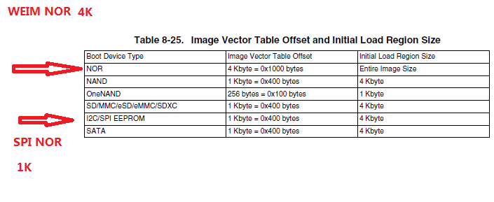

Thank you guys for the reply, so I used the mfg tool and it appears that it detects the device in the default settings, so I can flash my image with it, now I only have one confusion, I used the sample uboot bins provided with the mfg tool and uboot-spi-nor.bin and uboot-sabresd.bin have the same offset (1kb), the ref manual says that for nor the IVT (image vector table) should be at 4kb offset and sd should be at 1kb offset and that the offset of the IVT is the only requirement by the ROM, I ve checked all uboot bins provided and all of them are at 1kb offset. Now I can try with both and see which works, but wanted to know if there is any thing that I am missing....

BiyongSUN
1. WEIM NOR offset 4K.
2. SPI     NOR offset 1K.

ozu
Hi faizankhan,
I think you should check cfg.ini file in the MfgTool folder. In this file you can change the offset, at which you want to flash your uboot, by changing the 'seek' variable. This variable is used in ucl2.xml, which you can also find with the MfgTool folder. ucl2 uses a dd command to flash and for a 4kB offset u can set following things,
bs=1K (in ucl2.xml)
seek=4 (in cfg.ini)
Hope it helps!
