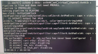

Eddy1
Contributor V
Thank you very much for your response. The customer is using two types of boards, 8mini and 8mplus. The Weston version on the 8mini board is 8.0, which doesn’t have the kiosk module yet. I am currently in the process of upgrading Weston to 9.0. Additionally, for the 8mplus board, it requires specifying the window position using waylandsink. However, based on your following modifications:
shell=kiosk-shell.so
After making the above modifications, I am currently unable to preview using the gstreamer:
The error is as follows:

brian14
Hi @Eddy1
Thank you for your detailed reply.
In my first response I answered with a solution based on Qt applications. However, for waylandsink used on your Gstreamer pipeline I found that this plugin doesn't support the fixed position.
Please have a look on the following threads:
imx8mp gstreamer issue:I want to set a video on fi... - NXP Community
Can't set a position for the top-level window (#183) · Issues · wayland / wayland · GitLab
Have a great day!
