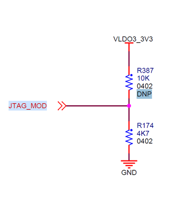

The JTAG_MOD pin on the i.MX7D SABRE board  is connected to a 10K pull-up register and a 4.7K pull-down register, but is the MPU in JTAG mode or SW mode?

joanxie
refer to the schematic, the pull-up is DNP, When JTAG_MOD is low, the JTAG interface is configured for common software debug,
