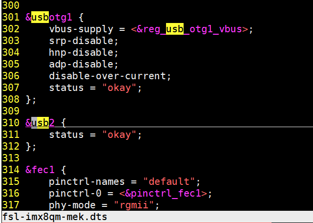

In imx8qm dts only have usbotg1 and usb2, there is no configuration associated with the typec.

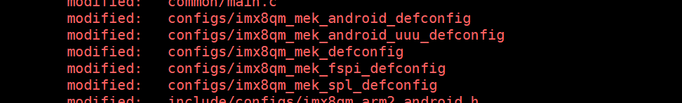

jack-cap
I tried to change all these files, but it still not work.微信截图_20200401104207.png
