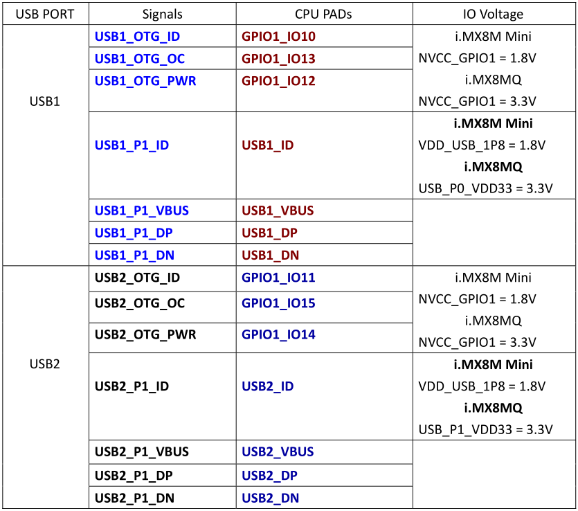

No.1 Hardware Design
1. IOMUX list
2 、USB circuit design

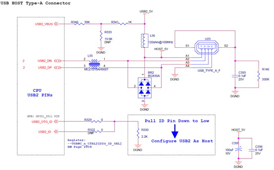

[Comment] For i.MX8MQ
-USB1 is configured as Dual Role Mode, USB1 OTG ID is used for detection
-USB2 is configured as fixed Host mode, USB2 OTG ID is used for detection
-i.MX8M Mini USB2.0
                                       i.MX8M Mini
                                    i.MX8M Mini
[Comment] For i.MX8M Mini
(3) Additional description
--About USB1_VBUS & USB2_VBUS of i.MX8M Mini
         According to i.MX8M Mini datasheet, USB1_VBUS & USB2_VBUS allows 0~3.9V input. See below, please!
Therefore, some customers have questioned the USB1_VBUS on the I.MX8M Mini-EVK. From the drawings, the external input voltage exceeds this range.
         In fact, customers do not need to worry about this problem. There are internal voltage-dividing resistors on the USB1_VBUS and USB2_VBUS pins. As long as the customer refers to the design method on the I.MX8M Mini-EVK, the input voltage of these 2 pins can be guaranteed Inside.
--About USBx OTG ID & USBx_ID
(1) USBx_OTG_ID
         USBx OTG ID is also called GPIO ID, which is the same as that of i.MX6Q. During the work process, the software changes the role between device and host according to the level of the ID pin from high to low or from low to high.
(2)USBx_ID
         USBx_ID is called USB PHY ID, which can also perform the same function as USBx OTG ID.
(3)Using USBx_OTG_ID or USBx_ID
         USBx_OTG_ID is recommended. But if customer wants to use USBx_ID, for i.MX8MQ, she can
configure USB_CTL0_ADDR[utmiotg_iddig_sel] register.
And for I.MX8M Mini, USBNC_n_CTRL2[DIG_ID_SEL] register.
[Comment]
         The configuration is got from reference manual of these 2 processors, due to no suitable board, this configuration is not validated on board. Customers can try it.
