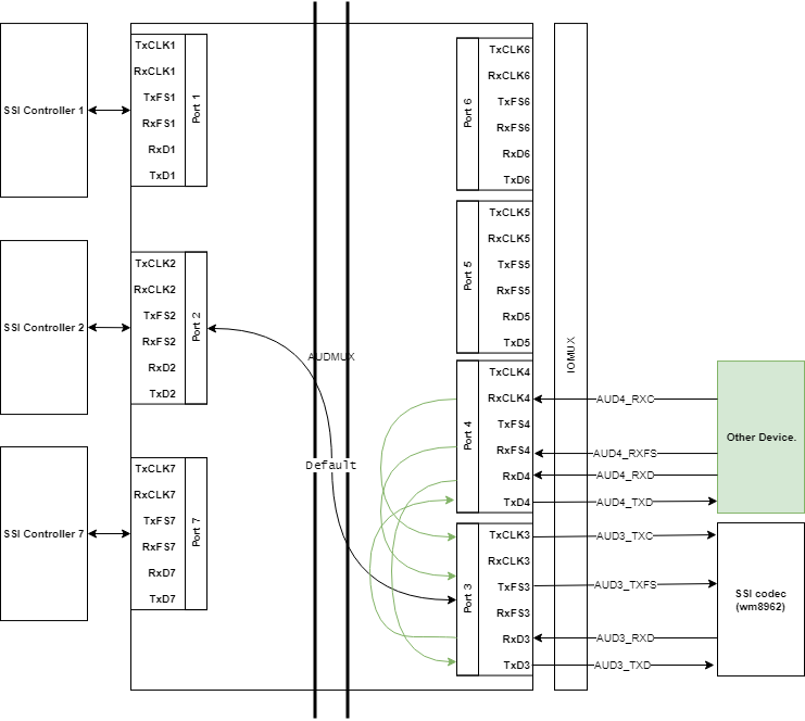

 Hi.
 i.MX6DL I have a question about how to set AUDMUX on Sabresd board.
 I connected the other device for transmit/received with audio codec. As shown below.
Other devices connected to the RxCLK4, RxFS4, RxD4, and TxD4 pins of AUDMXU Port4.ALSA-lm49350-develop.png
 Refer to the AUDMUX chapter "Internal Network Mode Example 3" of the data sheet (IMX6SDLRM.pdf) and set the register as shown below.
source code
int_port = int_port - 1; /* Port 2 */
ext_port = ext_port - 1; /* port 3 */
other_port = other_port - 1; /* port 4 */
ptcr = IMX_AUDMUX_V2_PTCR_SYN;
pdcr = IMX_AUDMUX_V2_PDCR_RXDSEL(ext_port);
imx_audmux_v2_configure_port(int_port, ptcr, pdcr);
ptcr = IMX_AUDMUX_V2_PTCR_SYM;
imx_audmux_v2_configure_port(other_port, ptcr, pdcr);
prcr = IMX_AUDMUX_V2_PTCR_SYN |
 IMX_AUDMUX_V2_PTCR_TFSEL(int_port) |
 IMX_AUDMUX_V2_PTCR_TCSEL(int_port) |
 IMX_AUDMUX_V2_PTCR_TFSDIR |
 IMX_AUDMUX_V2_PTCR_TCLKDIR;
pdcr = IMX_AUDMUX_V2_PDCR_RXDSEL(int_port) |
 IMX_AUDMUX_V2_PDCR_MODE(1) |
 IMX_AUDMUX_V2_PDCR_INMMASK(0xF5);
imx_audmux_v2_configure_port(ext_port, ptcr, pdcr);
 Is the above register setting code right?
 What is the status and direction of the Clock and Frame Sync signals when communicating with other devices and wm8962 devices? ( The signals of AUD4_RXC and AUD4_RXFS in the Other Device are input. )
 Please help me.
In addition, should the device connected to Port 5 in the Internal Network Mode example (Figure 16-8. Block Diagram For Example 3) be a SSI master device ?
Thanks.

igorpadykov
Hi vishnu
one can look at audmux examples in i.MX6Q baremetal sdk
and description in Chapter 5 Configuring the AUDMUX Driver iMX6_Firmware_Guide.pdf
(zip available on SMP Enable in IMX6 )
network example can be found in AN2628 Programming Audio Applications
https://www.nxp.com/docs/en/application-note/AN2628.pdf
igor
