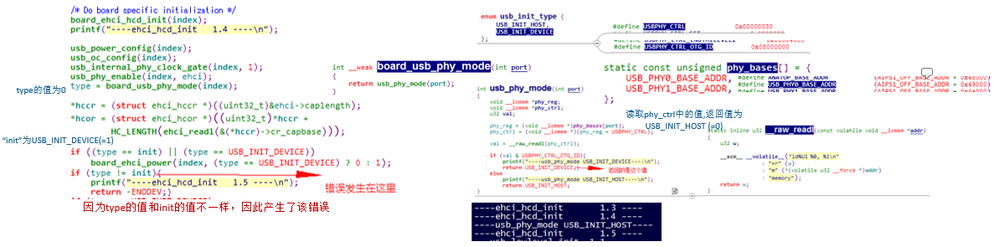

sunyd
hi,buddy
when i input command "fastboot"  ,but error that  info of  above image
 i check the code,and like that
but ,and i don't know how to reslove it, please help me
thank you !!!

igorpadykov
Hi sunyd
one can look at description on
Factory flashing with U-Boot and fastboot on Freescale i.MX6
Use nxp uboot from source.codeaurora.org/external/imx repository and
verify that there is "#define CONFIG_FASTBOOT" in
uboot/include/configs/mx6sabre_common.h
mx6sabre_common.h\configs\include - uboot-imx - i.MX U-Boot
