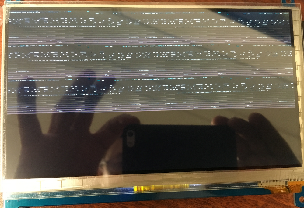

Hello NXP,
How can I configure our 7" display for HDMI on IMX7 Sabre board ?
We also have the iMX6 MCIIMX6Q-SDB and cannot get the HDMI working either.
Can you help us get the iMX6 or iMX7 to a 1024 x 600 at 60 Frames per second?
Here is what we are getting when connecting to the iMX6 or iMX7:

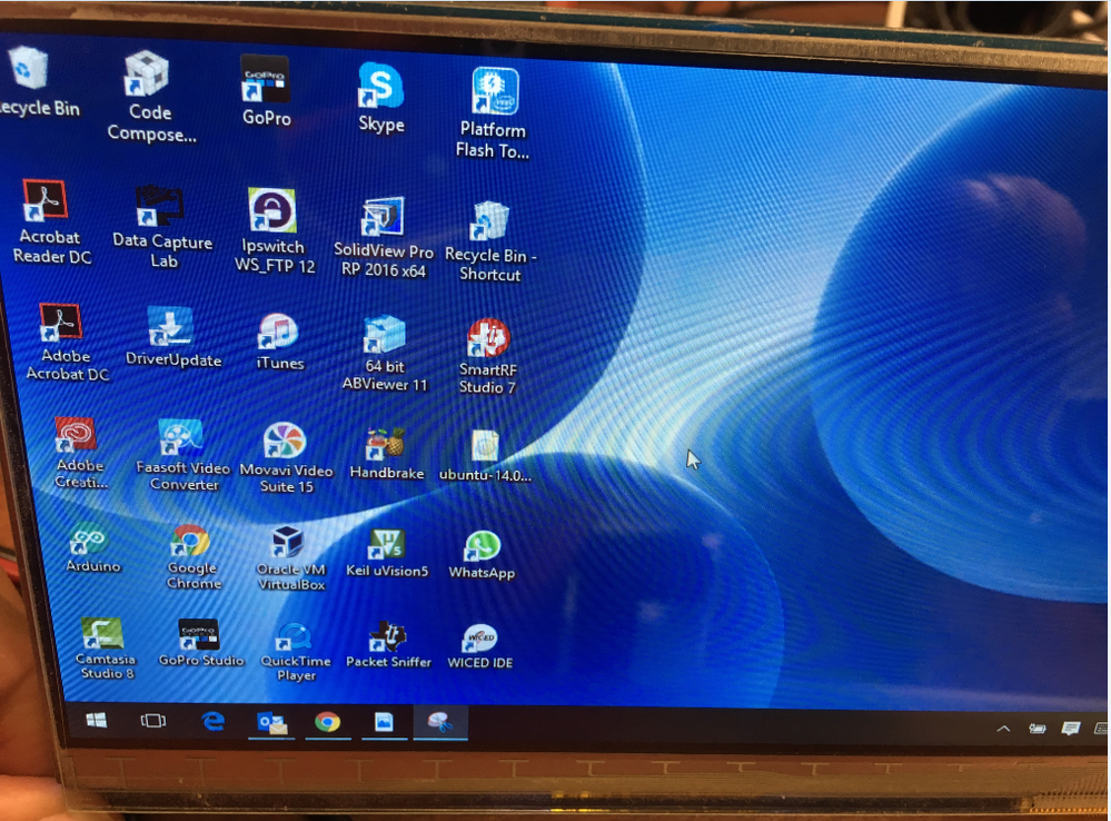

We have proven that the HDMI Display works with a laptop:
Thank you.

igorpadykov
Hi Jonathan
regarding i.MX6Q, HDMI driver selects video modes found in struct fb_videomode
in linux/drivers/video/mxc/mxc_edid.c
1024 x 600 is not formally supported by i.MX6Q HDMI according to
sect.33.4.3 Supported Video Mode i.MX6DQ Reference Manual
http://cache.freescale.com/files/32bit/doc/ref_manual/IMX6DQRM.pdf
one can try patch provided on
https://community.freescale.com/thread/379601
and check
http://lists.denx.de/pipermail/u-boot/2012-October/136234.html
For i.MX7 HDMI support suggest to create new thread, shortly
one can change resolution in imx7d-sdb.dts:
http://git.freescale.com/git/cgit.cgi/imx/linux-2.6-imx.git/tree/arch/arm/boot/dts/imx7d-sdb.dts?id=...
    sii902x: sii902x@39 {
        mode_str ="1280x720M@60";
igor

igorpadykov
Hi Jonathan
both 1280x720 and 1920x1080 are supported hdmi modes and
should work with any monitor. I.MX6Q demo images on below link work with
1920x1080
i.MX 6 Series Software and Development Tool|NXP
igor

igorpadykov
Hi Jonathan
as 1024 x 600 is not formally supported by i.MX6Q HDMI
you may wish to apply to Professional Services to develop that
non-standard solution
http://www.nxp.com/support/nxp-professional-services:PROFESSIONAL-SERVICE
ProSupport@nxp.com
igor
