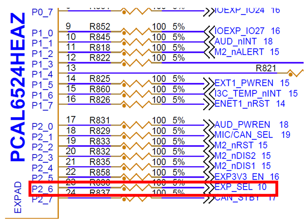

I'm using iMX93QSB and i'm tryng to debug GPIO interface of the processor using prebuild linux image. I would like to change the P2_6 pin of the GPIO expander PCAL6524HEAZ which drives the selection pin fo the TMUX used on the board.

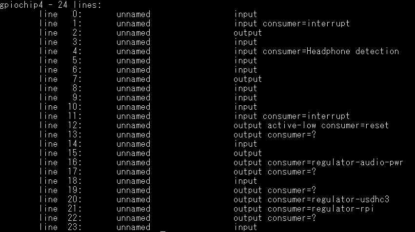

Thanks to the driver I can see the GPIO expander as the gpiochip 4 and I should be able to move the pins by using libgpiod commands like: gpioset -t0 -c 4 22=1 .
But when I try to access to pin 22 (that is corresponding to P2_6) I receive the following message:
so I checked the gpioinfo and I notice pin 22 is used by "consumer = ?":
I cannot understand why isn't possible to change a gpio pin that's routed in order to be a selection pin.
Can you help me? How can I change my selection mode from command line?

JorgeCas
That GPIO is used for shared GPIO mux on QSB board.
It is defined here.
To use it, you need to change the definition on that node to make it available.
Best regards.
