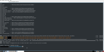

$ cd ~/imx-yocto-bsp
$ DISTRO=fsl-imx-xwayland MACHINE=<machine> source imx-setup-release.sh -b <build directory>
$ bitbake -c devshell virtual/kernel (it will open a new window)
On Devshell window.
$ make dtbs (after finished, close the Devshell window)
On host machine.
$ bitbake -c compile -f virtual/kernel
$ bitbake -c deploy -f virtual/kernel
This process will compile all the device tree files linked to the machine declared on setup environment and your device tree files will be deployed on the next path:
~/imx-yocto-bsp/<build directory>/tmp/deploy/images/<machine>
