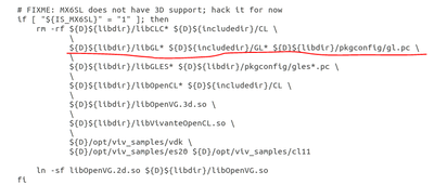

I tried to port qt4 with OpenVG support on imx6 solo lite based on following page https://community.nxp.com/t5/i-MX-Processors-Knowledge-Base/Building-QT-for-i-MX6/ta-p/1111319. However, inside"imx-gpu-viv_6.2.4" recipes, the OpenGL libraries are removed.
So I am unable to compile the eglfs plug-in with qt4. Should I just comment on the rm GL* and libGL*  or I need to find other ways to enable openVG with qt4 on imx6sl?
Thanks for your help.

Hello AccuJie,
If you want to run qt4 you need the 4.1.15v BSP, since is not available from every new kernel:
https://www.nxp.com/design/software/embedded-software/i-mx-software/embedded-linux-for-i-mx-applicat...
