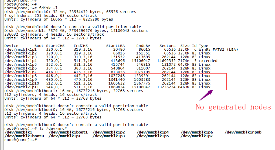

Please try to create the node with the command like this: # mknod /dev/mmcblk1p8 b 9 40 Here 9 and 40 are not actual numbers. Please first do "ls -l /dev/mmcblk1p7" to get its major and minor numbers, then use major and minor+1 for mmcblk1p8.
