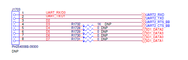

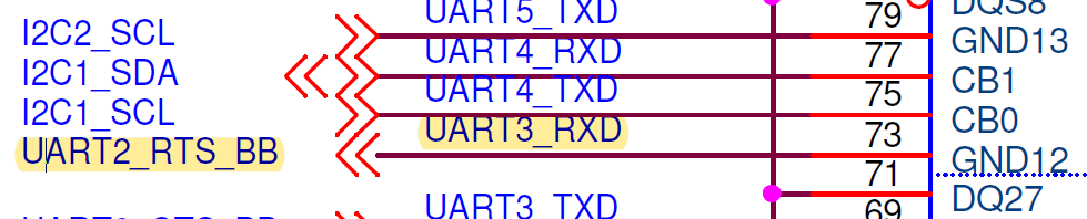

My name is Toan. And I'm using iMX6UL-EVK. Currently, I'm trying to configure GPIO and get a trouble. In schematic, I see that pin D2 is usable as GPIO and find out number of pin. And I found that pin is gpio1.IO[25]. Because It's belong to GPIO1 so I don't need to plus with any value. Then I executed:
$ echo 25 > /sys/class/gpio/export
$ echo "out" > /sys/class/gpio/gpio25/direction
$ echo 1 > /sys/class/gpio/gpio25/value
Then I test with a LED  but the light is quite weak. Then I try to set:
echo 0 > /sys/class/gpio/gpio25/value
But the LED is still lighting.
I tried to test with 3.3V power in this board, LED is light very strong.
What should I do now ? Do I do wrong somewhere ?
Thank you so much,
      Toan

Hi Dao Van Toan,
To use GPIO1.IO[25] as a gpio one can change the status as "disabled" of UART2 node in device tree (imx6ul-14x14-evk.dts). In default configuration this pin is used as a UART2.
  &uart2 {
          pinctrl-names = "default";
          pinctrl-0 = <&pinctrl_uart2>;
          uart-has-rtscts;
          /* for DTE mode, add below change */
          /* fsl,dte-mode; */
          /* pinctrl-0 = <&pinctrl_uart2dte>; */
          status = "disabled";
Radhika Somaiya.

Yuri
  Please check if GPIO is declared in Your devicetree.
Yuri

toanjunifer

Thank you for quick reply. After read imx6ul-14x14-evk.dts file, I found this:

I actually don't understand clearly. May you explain more details ?
- Is this dts file needed to customize ?
- How to delare GPIO pin ? May you give me some example ?
Thank you so much !
      Toan
4,556件の閲覧回数
Yuri
  use imx6ul.dtsi : gpio1 should be included; uart2 disabled.
imx6ul.dtsi\dts\boot\arm\arch - linux-imx - i.MX Linux kernel
Yuri.
