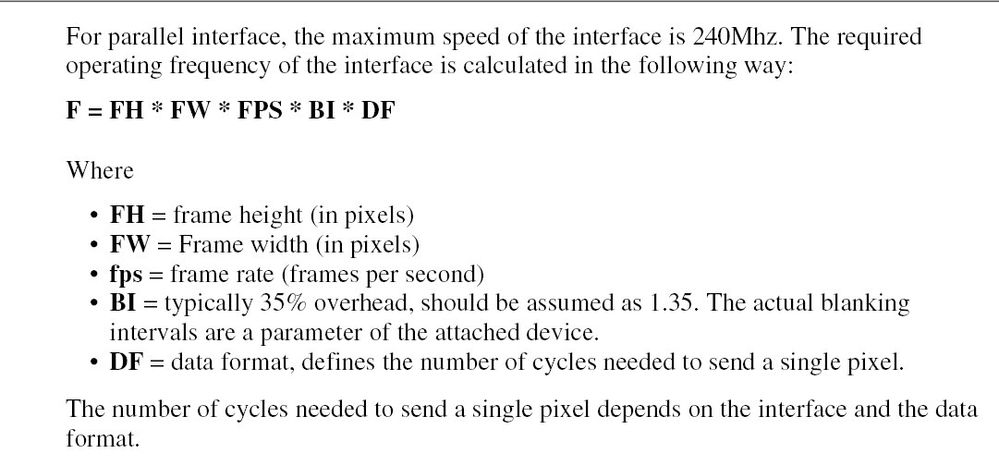

I want to design with iMX6 dual.
I will connect dual parallel camera.
Cam1 = 1280*720*30fps, YUV ->  IPU#1_CSI0
Cam2 = 2560*1920*30fps, mono Bayer -> IPU#2_CSI1
Display = Parallel display port
Board has to capture two camera at same time and  diplays with Cam1.
Cam2 has to be saved to memory.
Is it possible?

HI chilwonna
in general yes, this may be supported as max. performance is 240MHz per IPU
igor
