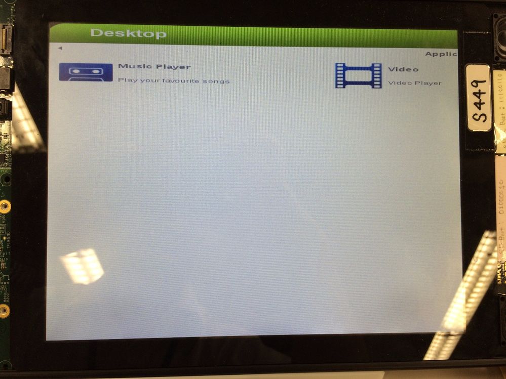

SABRE-SDP could output to the dual LVDS Display by your command.
Thank you.
But, when I tried to video play on the secondary display, primary GUI display became strange.
(Video play on secondary display was no problem.)
Do you know why is the phenomenon happened?
Keita
2,270 Views
BiyongSUN
if you just want to dual same UI on the LVDS0 and LVDS1. And it is the SDP board.
Use the prebuild binary image. Only change the device tree.
Modify the device tree and add  dual-mode; at line 817.
The attached imx6q-sabresd-dul.dtb is what I have tried working fine with  MCIMX6Q-SDP + MCIMX-LVDS1, 3.14.28_1.0.0_ga.
